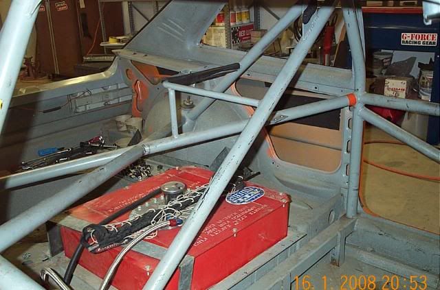

Fuel cell moved to passenger side because it reduces the polar moment of inertia (makes it easier for the car to turn) when more of the mass is closer to cg of the car, offsets the driver weight better, and can sit lower (rules specify minimum height for a fuel cell mounted under the car, not one inside...)
