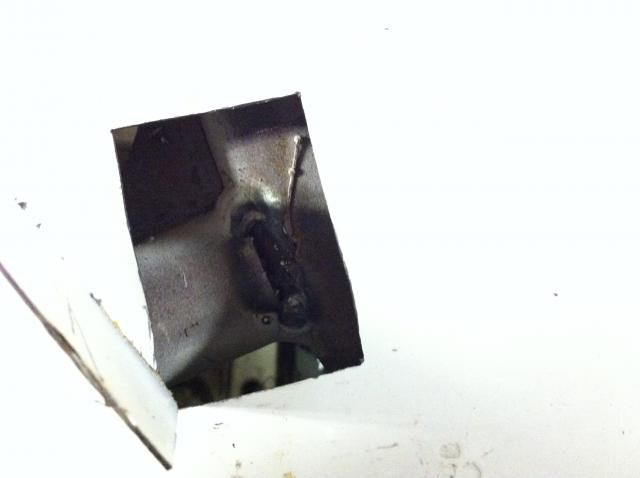

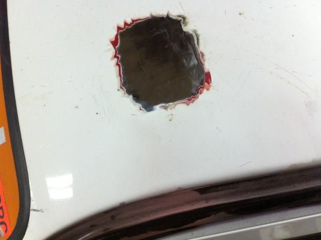

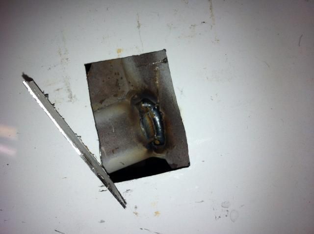

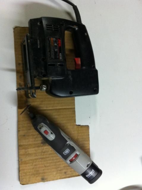

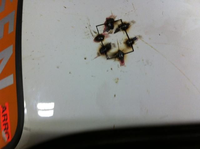

Had some cage repair to do. The guy that built the cage took a shortcut that left about 1" not welded at the top of the A pillar down tubes. I never found this until the last time I raced - when the tech inspector found it. It was not welded because you can't reach it, so most builders will cut holes in the floor, drop the cage down, weld them up, then raise the cage, slip mounting plates under the tubes and weld it up.
So - I needed to fix this. Here is how I did it:
The smallest metal cutting blade I could get, without buying a new tool, was one for an old jigsaw. So I used a dremel to start each cut, and then the jigsaw to make it.
I cut 95% of the way around a square:
Opened it up to see the not welded section:
Welded it up:
Tacked the panel back in place:
Patiently (but not patiently enough, there was some warping) added short weld sections, and took breaks to let it cool to weld it all the way up:
The section of the roof is a bit convex, and the heat pulled it down slightly concave. So I should be able to make it look race car acceptable with a touch of filler. Got both sides fixed. Now just need to move one tube and add a few extras to tie in the front strut towers.
