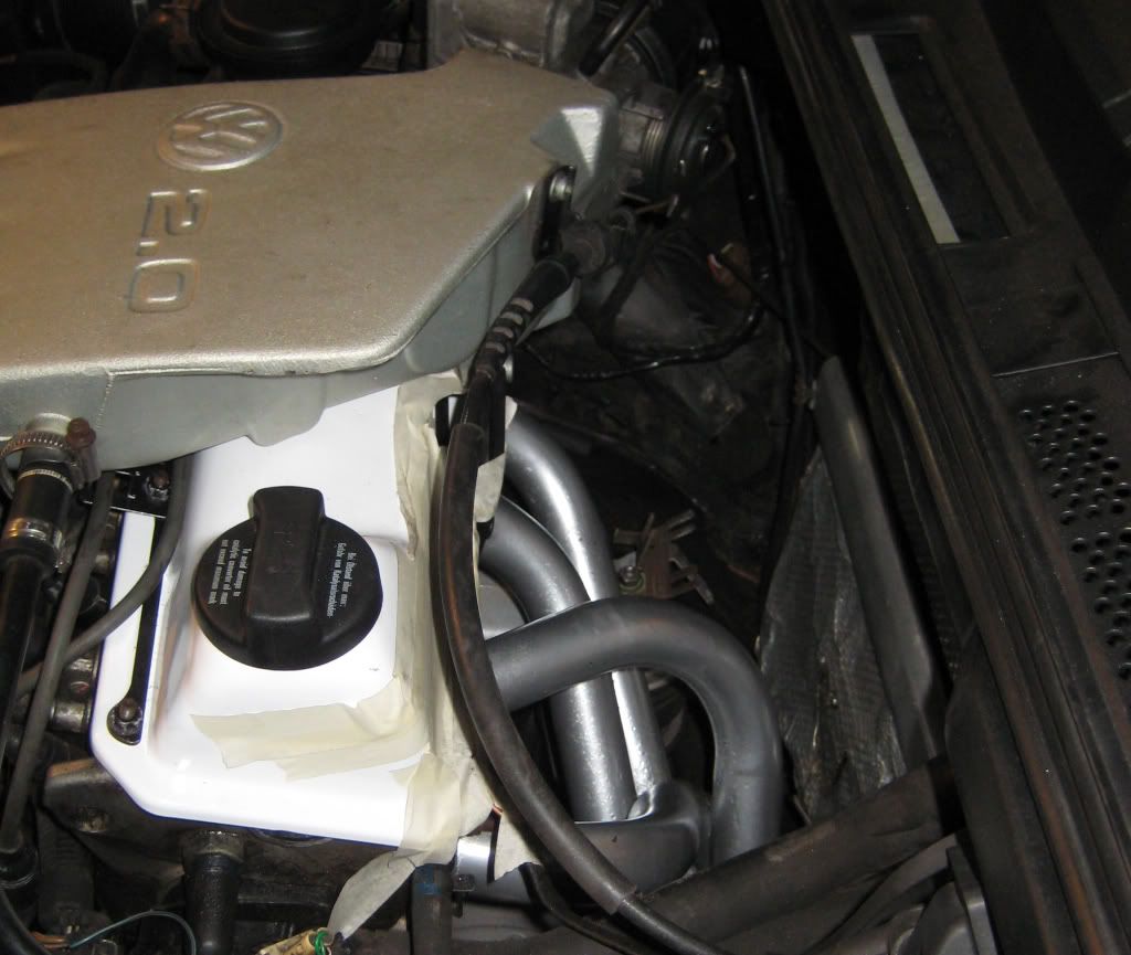

The previous update on the car talked about starting the build of the exhaust. The header was rebuilt with a larger pipe with a 3-bolt flange bolted to a matching flange on the muffler. The muffler sits under the shifter in the widest section of the exhaust tunnel and at the last update ended at the muffler with its dual outlets. With the muffler in place the engine was prepped for a test fire (with the car still up on jack stands) for the first time since the spring. The purpose was to ensure that all systems were still operational, that the exhaust wouldn’t hit the body with the engine running, to check the alignment of the drive belts, refill the coolant with the water pump running, refill the trans after running it through the gears, make sure the clutch felt ok, and that nothing leaked. The test run went perfect although I was surprised at how little fluid both the cooling system and trans required. Either the fluids weren’t completely drained or they are not totally filled –both of these will be double (triple) checked before any serious driving.

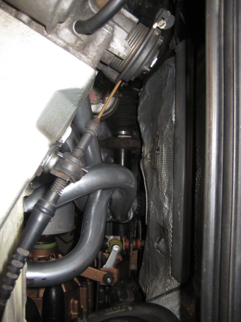

When the clutch operation was checked it felt like there was a lot of slack in the clutch pedal. The clutch cable had been swapped between an automatic and manual clutch cable a few times and it was thought that the automatic cable was operating correctly. After testing the clutch operation on jack stands, the auto cable wasn’t taking out the slack in the clutch pedal that it should have, so the manually adjusted cable was swapped in again. A benefit of having a partially stripped interior is that the clutch cable is more accessible under the dashboard. You still have to lie on your head in the footwell to disconnect/reconnect to the clutch cable, but nothing needs to be removed under the dash.
There is no flex section in the header, so the risk of the exhaust hitting the body was unknown. Since the motor and trans mounts have all been significantly stiffened it was good to see that the engine didn’t budge when revved. It is possible that significantly more torque will shift the engine when the wheels are on the ground, but hopefully it is not an issue.

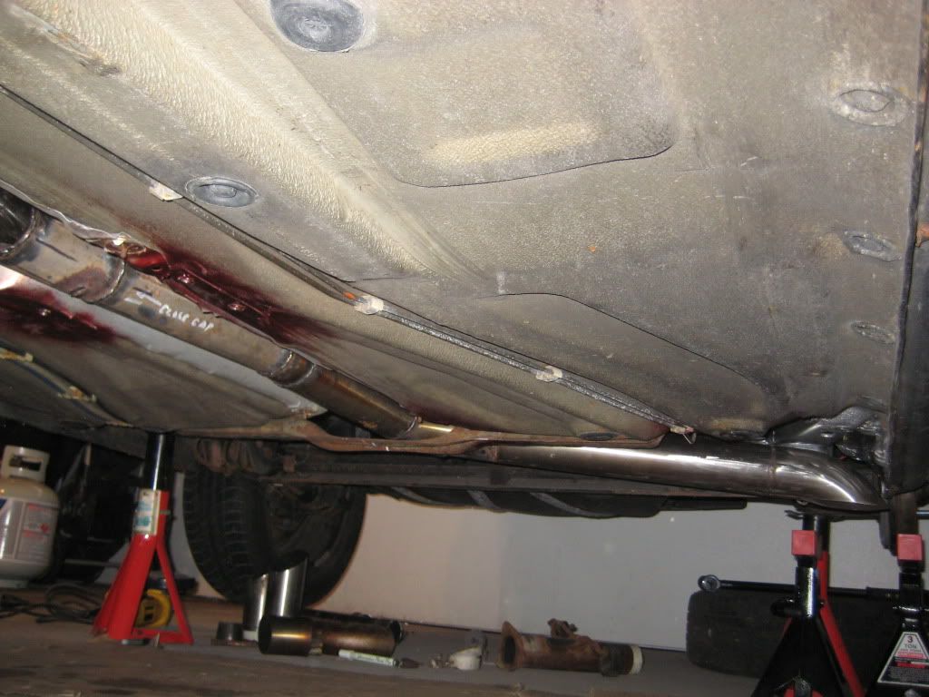

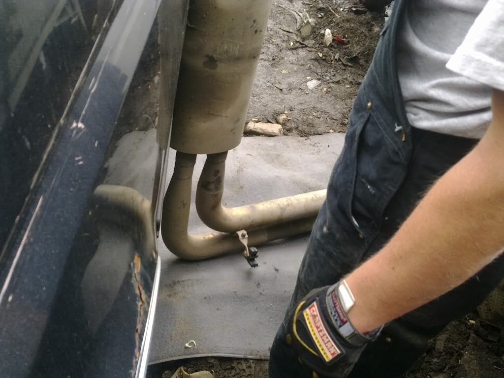

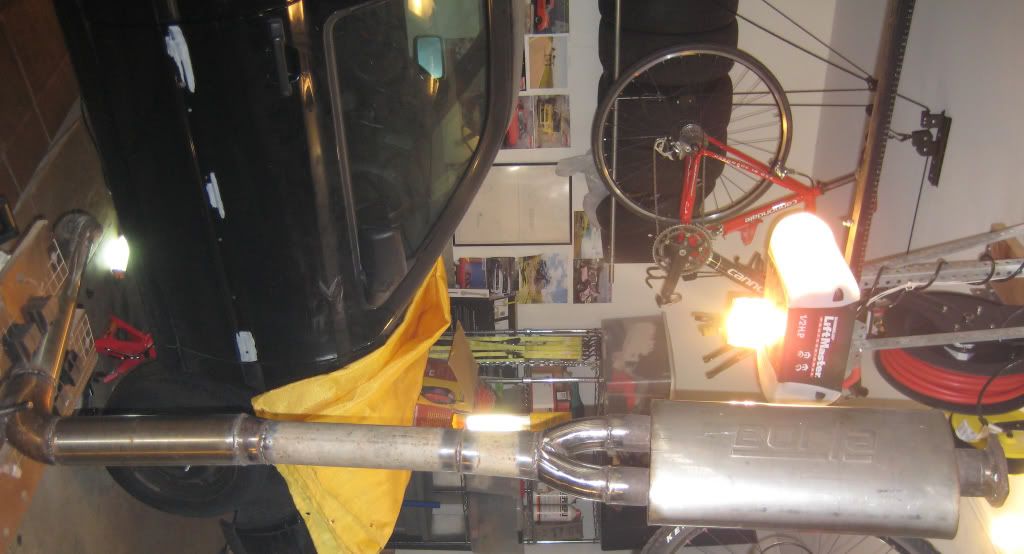

The last update ended at the muffler. The stainless Borla muffler came off a junkyard truck. The Borla was picked since it wasn’t rusty and is from a quality manufacturer. It also included two long sections of stainless 3” piping with mandrel bends coming off of it that I can cut and repurpose. Although the junkyard pics make it look dirty, there is potential. These pics make me look a bit redneck, but it’s an effective JY outfit, thanks to Jeremy for the pics:

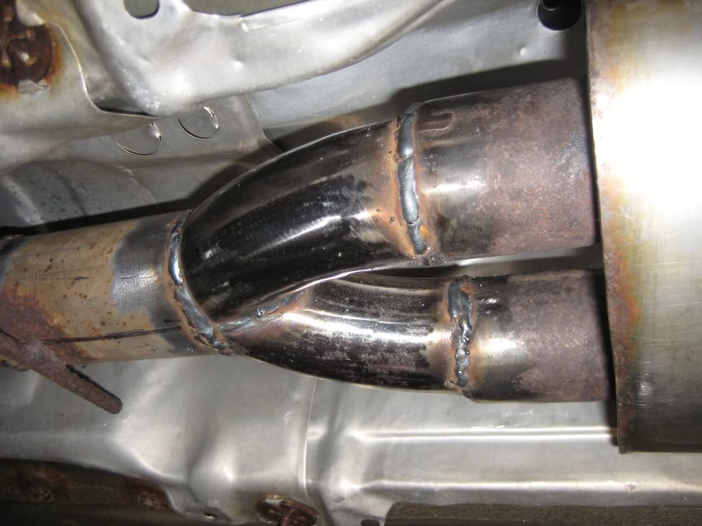

All of the junkyard piping needed to be cleaned up and re-welded in a different configuration for the Jetta, but it was cheap at just $30 for about 12 feet of stainless mandrel bent pipes and a name-brand muffler. The plan for this GRM Jetta is to use 2.5”-3” exhaust piping - way overkill for the ABA motor, but leaves room to expand to a turbo down the road. The muffler has a 2.5” inlet and dual 2” outlets, although the plan is to run a single pipe, not duals. The next thing to figure out was how to bring the dual muffler outlets back together to a single pipe. Two 2” bends were cut and welded to a 2.5” pipe, creating a merge pipe:

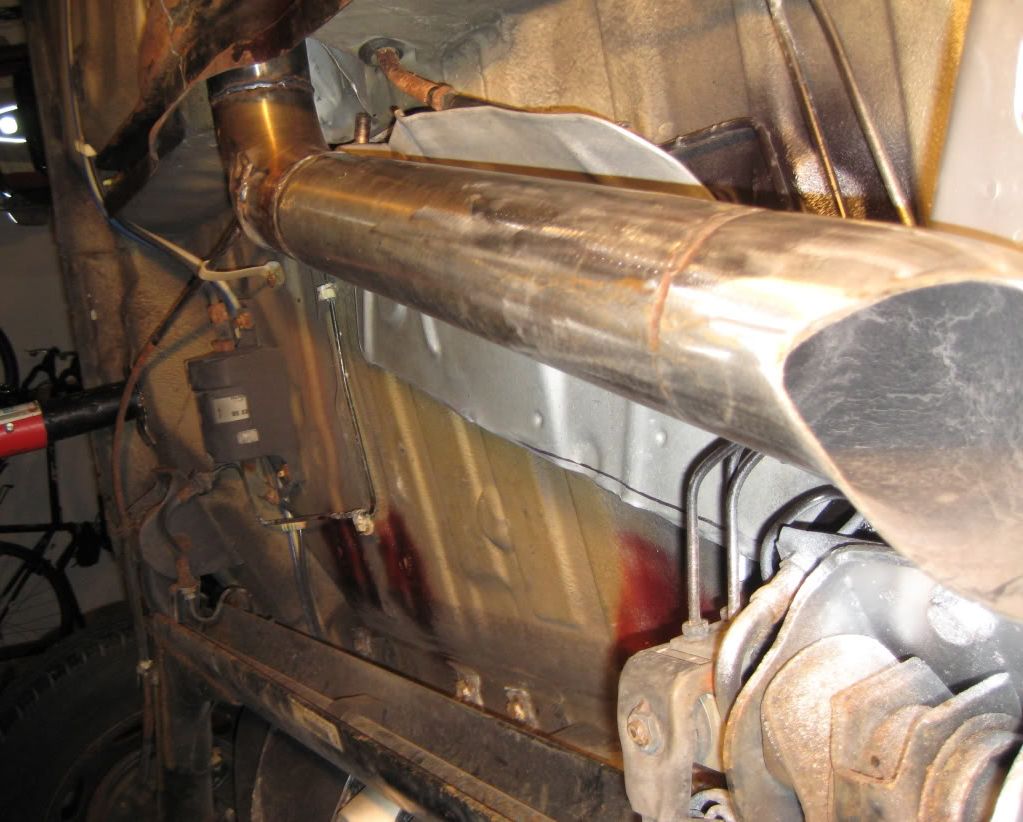

From the merge pipe a 2.5” pipe runs back to a cone shaped transition to 3” pipe for the 3” stainless that forms the side exit.
Side exit exhaust is desired to cut out as much weight as possible by keeping the system short. The driver’s side exit was chosen since the passenger side is already occupied with the fuel pump and fuel lines – an area the hot exhaust pipes should avoid.

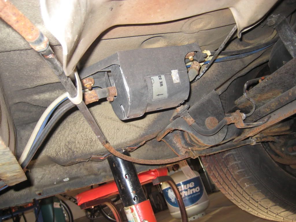

Passenger side no go:
Although there are still some minor space conflicts on the driver’s side with an emergency brake line and the proportioning valve for the rear brakes – these can both be resolved simply. The brake lines were bent up a little bit to be out of the way and the emergency brake cable was rerouted OVER the rear beam axle.

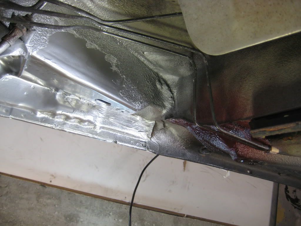

I had read VWGuyBruce’s account of the fire he suffered in his GRM Jetta a few years ago. My understanding is that he had removed the factory heat shielding and his hot exhaust/muffler started a fire of the undercoating in the same area where my exhaust will be exiting. To prevent the same from occurring I’m retaining a cut down OEM heat shield and scraping off the undercoating and respraying with some high heat reflective paint:
Scraped/ground off undercoating:
Primed the bare metal and covered the area with high heat paint:

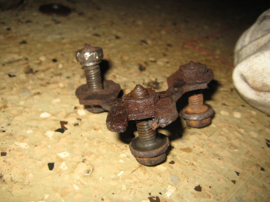

In the pic above you can also see where I had ground off some studs in the floorpan that were no longer needed, these are the areas that are sprayed with some maroon spray paint left over from a Jeep project almost 20 years ago. The same paint was used when I drilled out the broken studs holding the cross brace across the tunnel and tapped the holes. Trying to prevent any bare metal showing and eventually rusting:

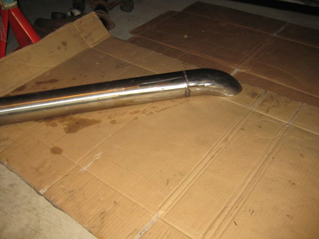

A turn down style tip was chosen to keep the exhaust from hanging below the body. Some cars are notched to allow side-exit exhaust, which can look great, but it seems like a unibody car without a rollcage would give up a lot of body rigidity with this area of the unibody cut. Here is what the side pipe started out as:
And cut down to:

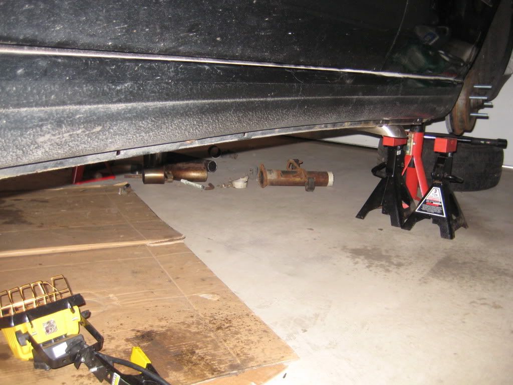

Here is the entire exhaust (minus header) being finish welded off the car:
Here is an idea of how it was hanging under the car:

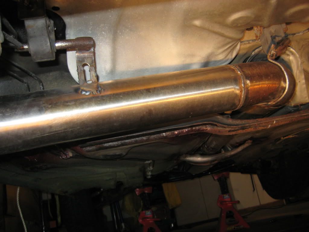

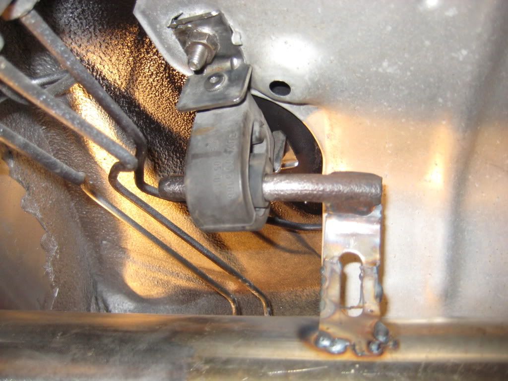

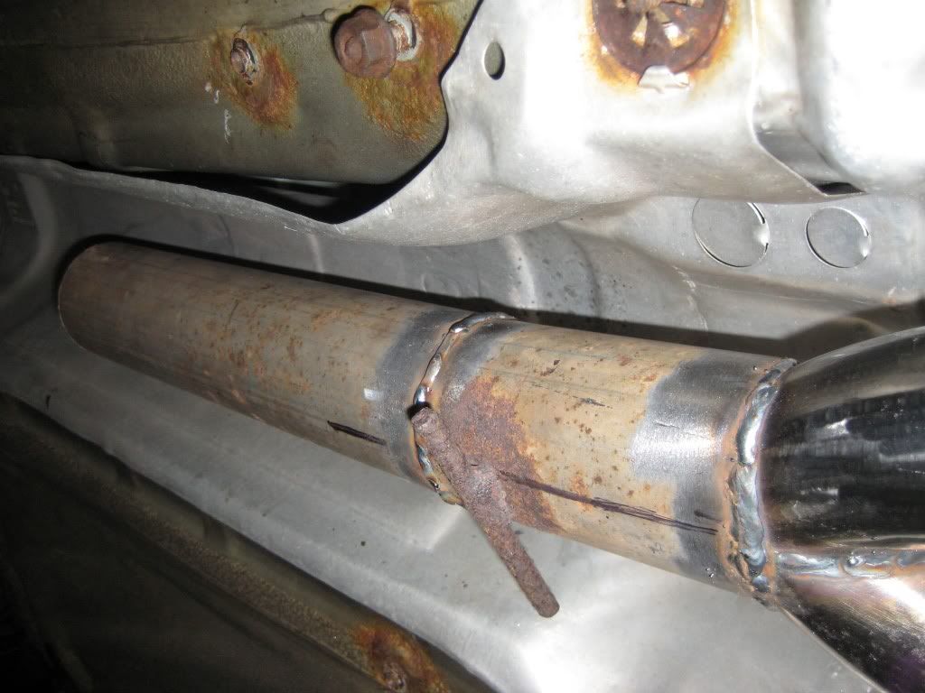

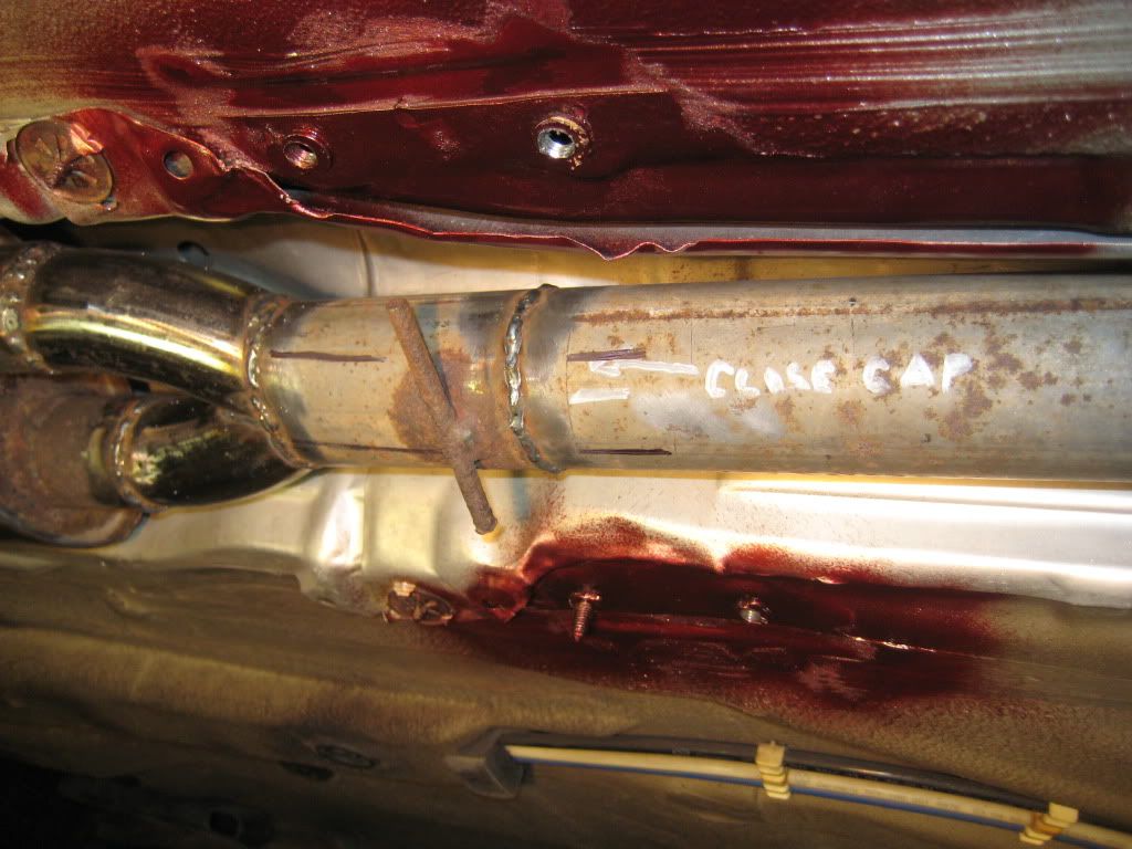

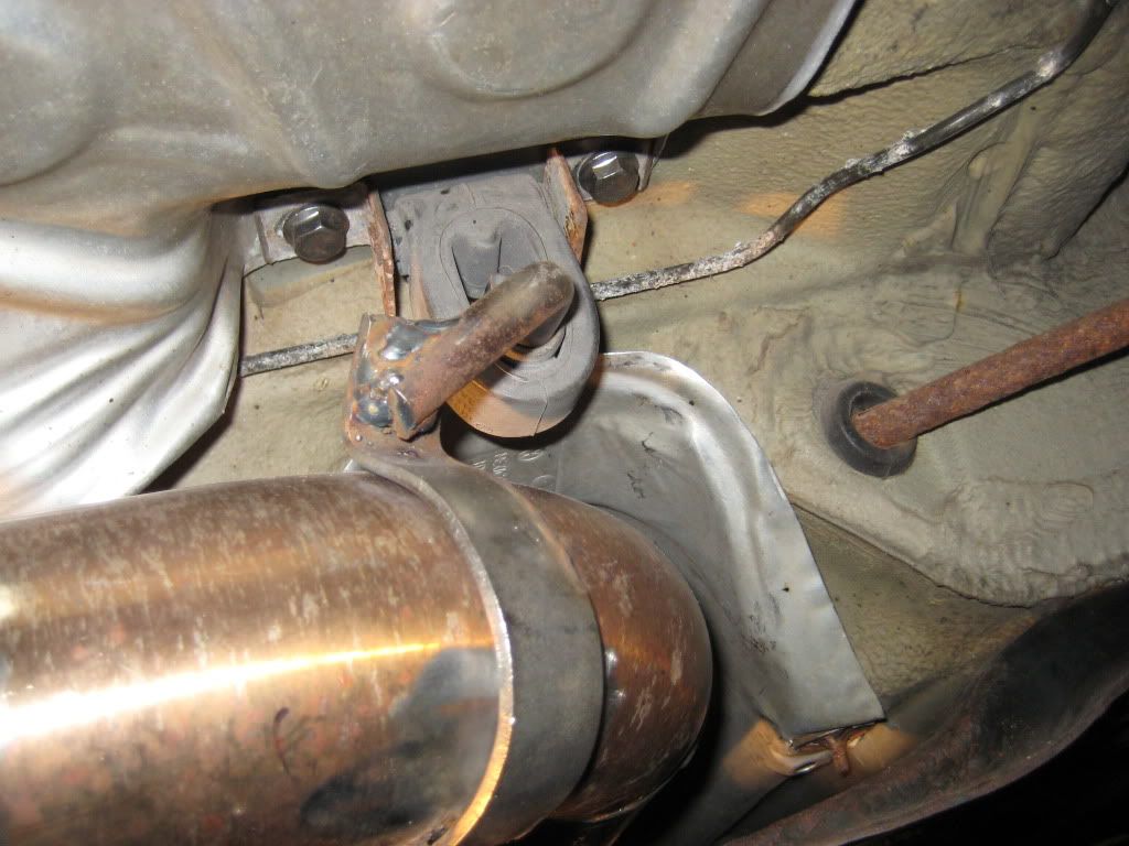

The last step of running the new exhaust was incorporating hangers into the pipes to support the weight of the system and take stress off the header. The hanger at the rear of the tunnel was used but didn’t prevent the side pipe from exerting a twisting force at the header. Another hanger was installed with some studs made from chopped up bolts and welded near the rear brake junction/modulator. These studs served as a location to hang an OEM exhaust hangers and secure the cut down OEM heat shield.
You can see the cut down heat shield:
Held up by the new studs/exhaust hanger:
And the original exhaust hanger at the end of the tunnel:
A shot from under the spare tire well showing both hangers:

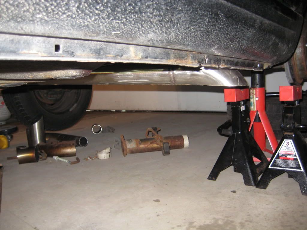

Throughout this exhaust build each piece was on and off the car countless times. Now that everything fit I took it all off again since I had to pull the header to add an O2 bung and paint it with some high temp paint. I didn’t get any shots of the O2 bung, but part of the reason the progress is so slow is because things like recycled O2 bungs are a big time sink. From a budgetary stand point it made more sense to cut a used bung out of the old cat rather than buying a perfect new one for $4 or whatever. Here’s how the finished painted header turned out installed:
The finished exhaust just barely peeks out from under the side of the car:

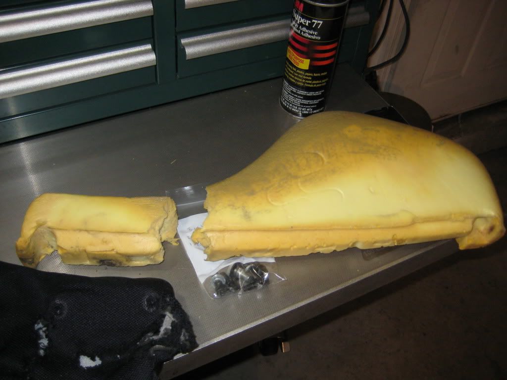

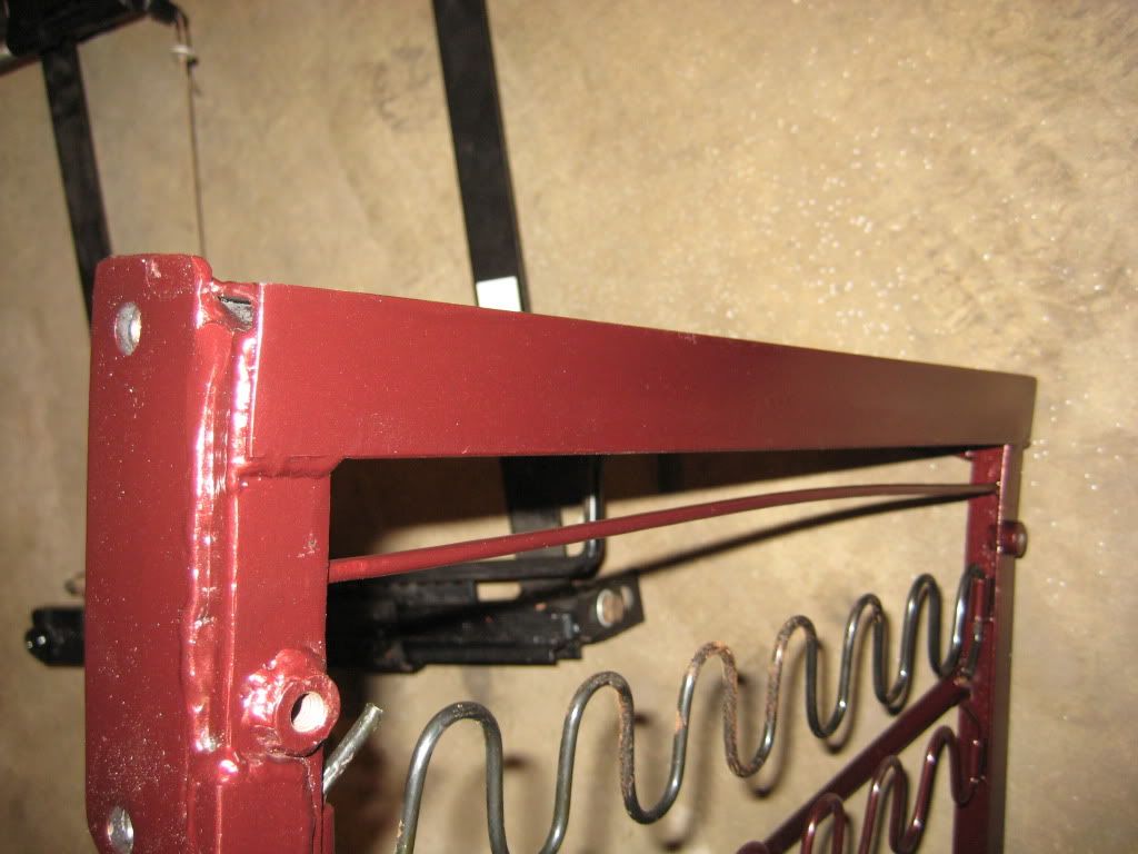

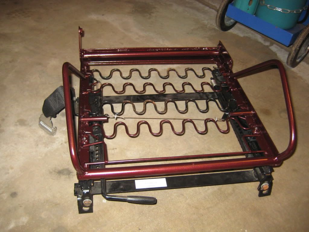

The other thing that was done was to repair the broken Tenzo (JDM yo!) seat that I had picked up last year. I was originally planning on installing these in the car after they were fixed, but decided to stick with the original seats for now. I’m planning on selling these. When I got the seat the frame was cracked. That also ripped the bolster. The base was butt welded back together and then some angle iron was used to make some reinforcing patches over the butt welds, the whole thing was painted with that same old maroon spray paint:
The bolster was fixed by gluing it together:
And the whole thing reassembled remarkably easy. Stuck up in the attic for now until I get a chance to make a craigslist posting.

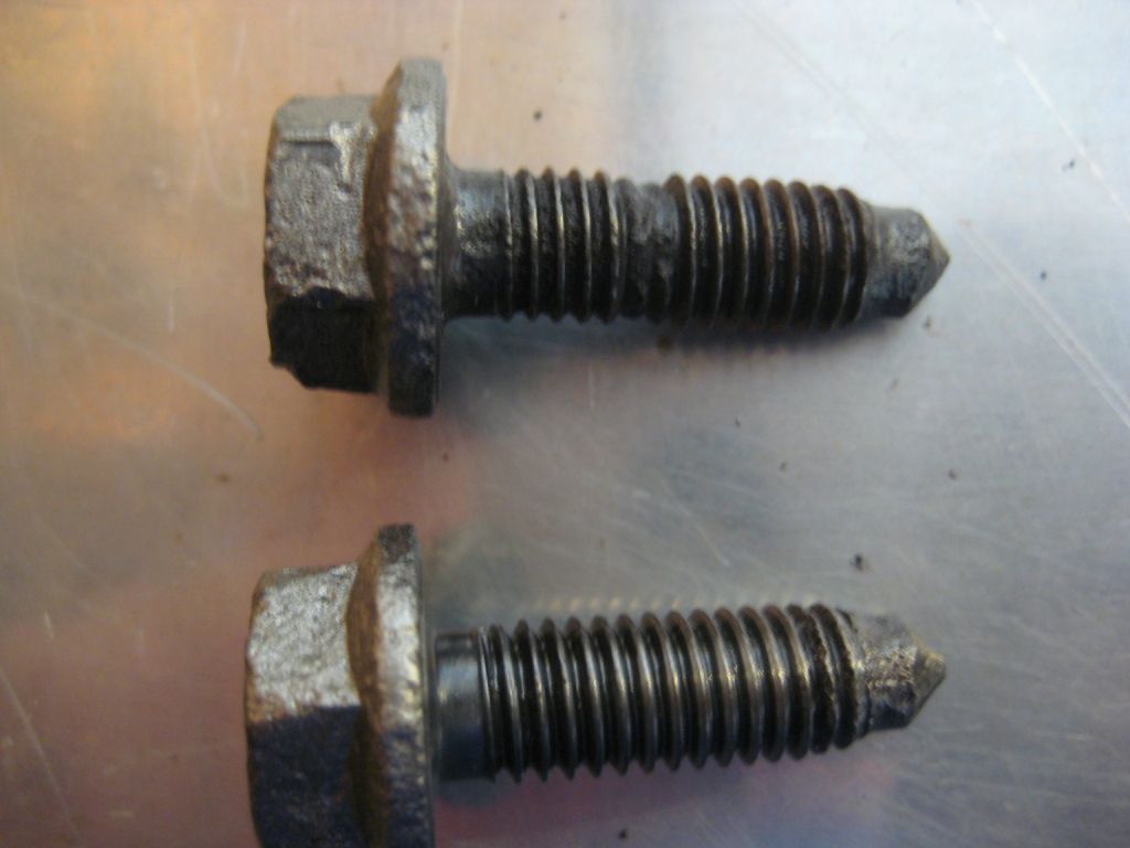

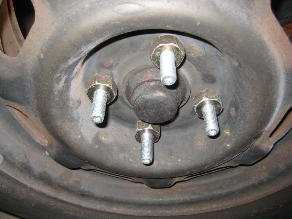

Studs installed at all four wheels:

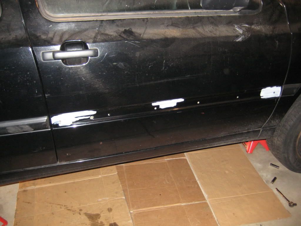

There was some epoxy glue holding on the missing door molding that was scraped off, some scrapes went down to bare metal that was primed on the door:

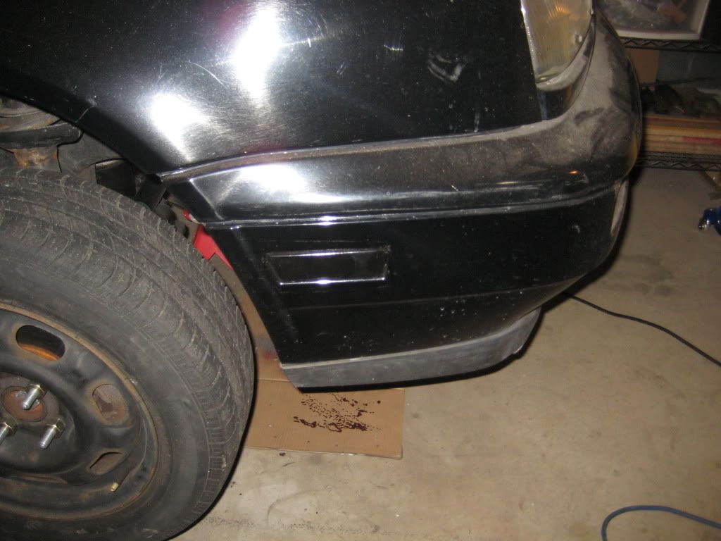

Blacked out sidemarkers glued in:

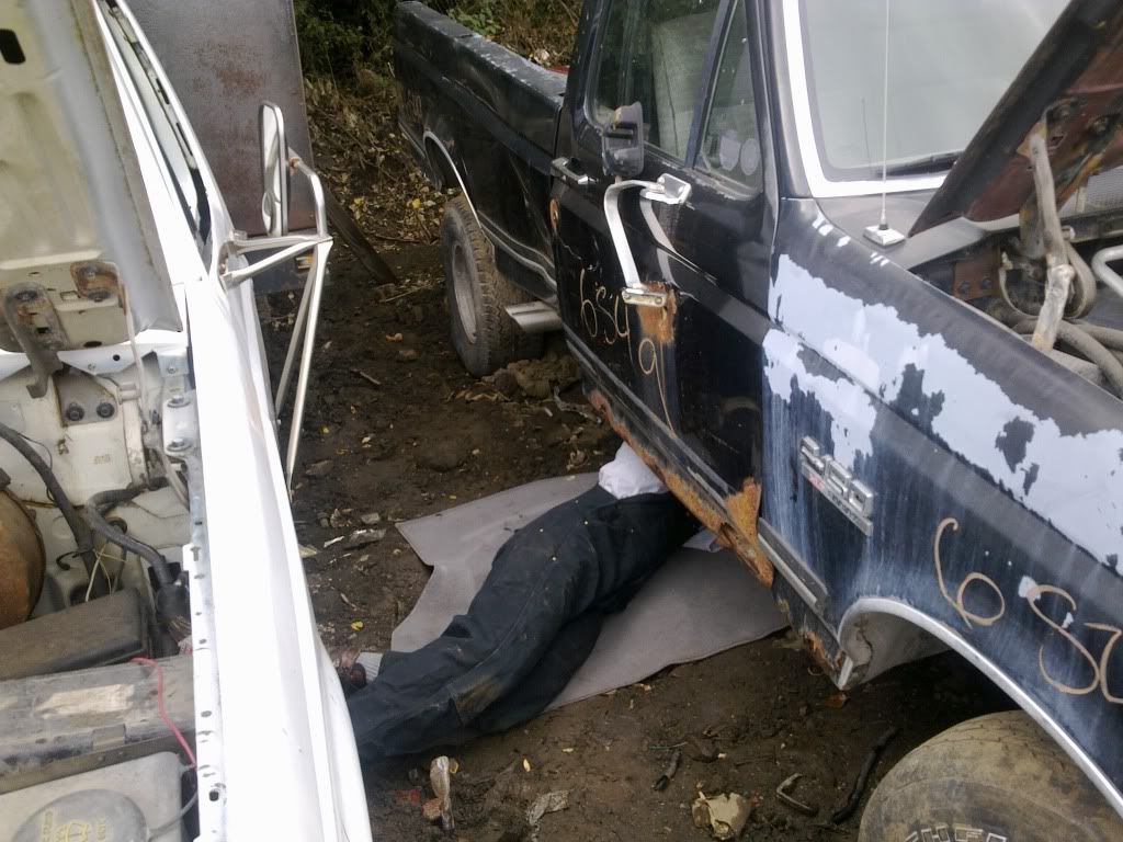

Long front door bar and shorter front door bars shown, one in each door. Front doors also have an aluminum bar:
Both rear doors have now been completely gutted. I gutted the remains of the door the same way I did the driver’s side rear last month (April 2012), although I didn’t go through the time intensive step of drilling the holes. Eventually I’d like to rivet/bolt in lexan rear windows and cut away a little more of the door structure, so I’m not going to sweat about what is remaining on the door frame.

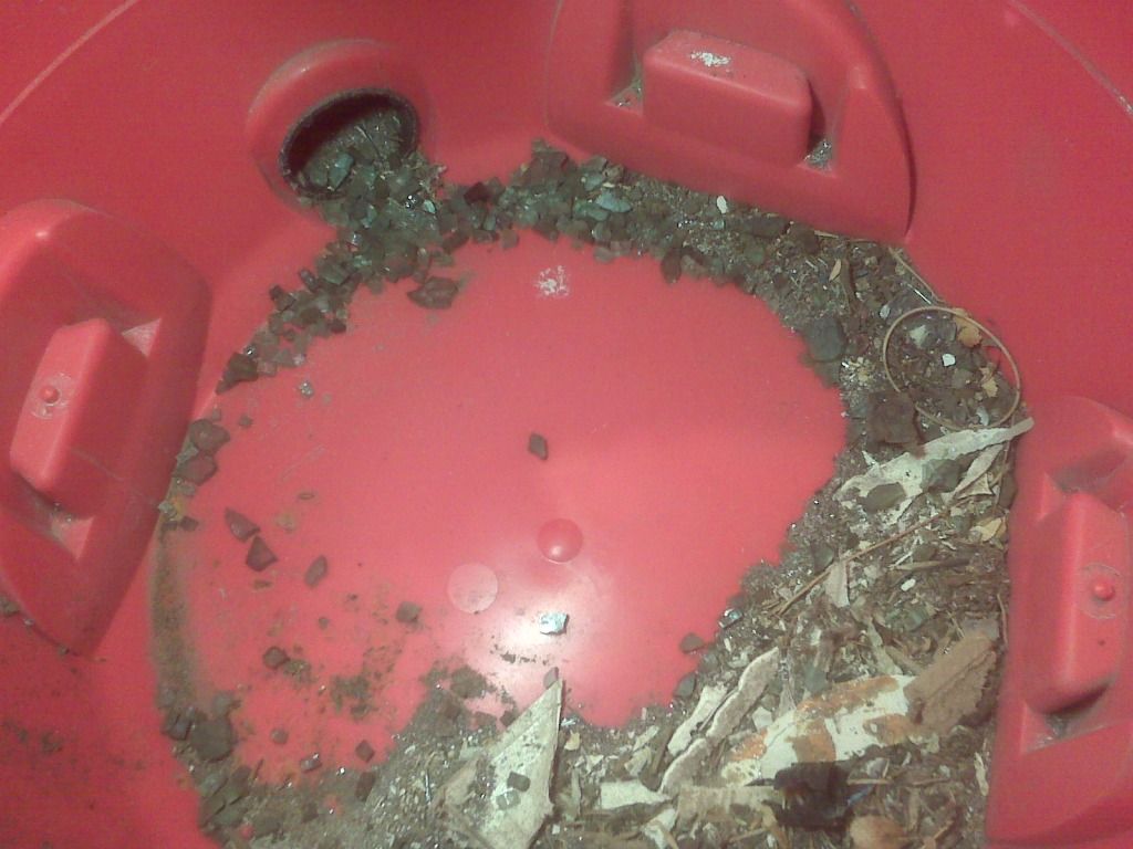

While cleaning out all the doors I’m seeing evidence that this car had been broken into several times, lots of broken glass in a couple of the doors. Did I mention that the previous owner bought this car in L.A.?
Lots of glass in the shop vac:

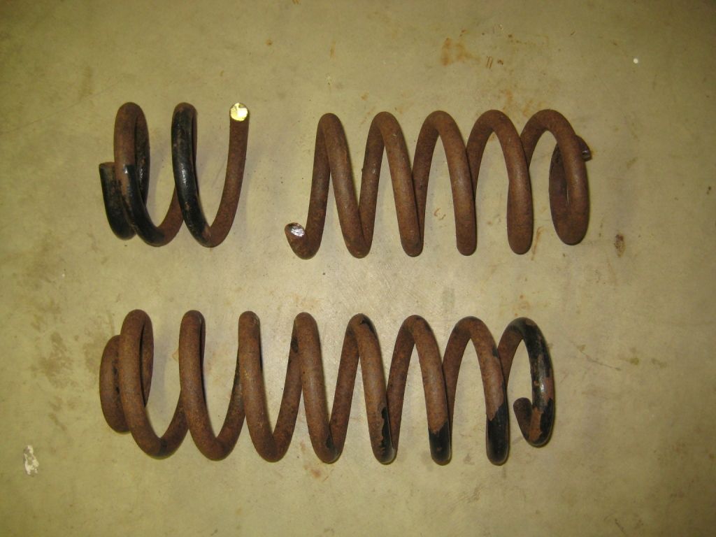

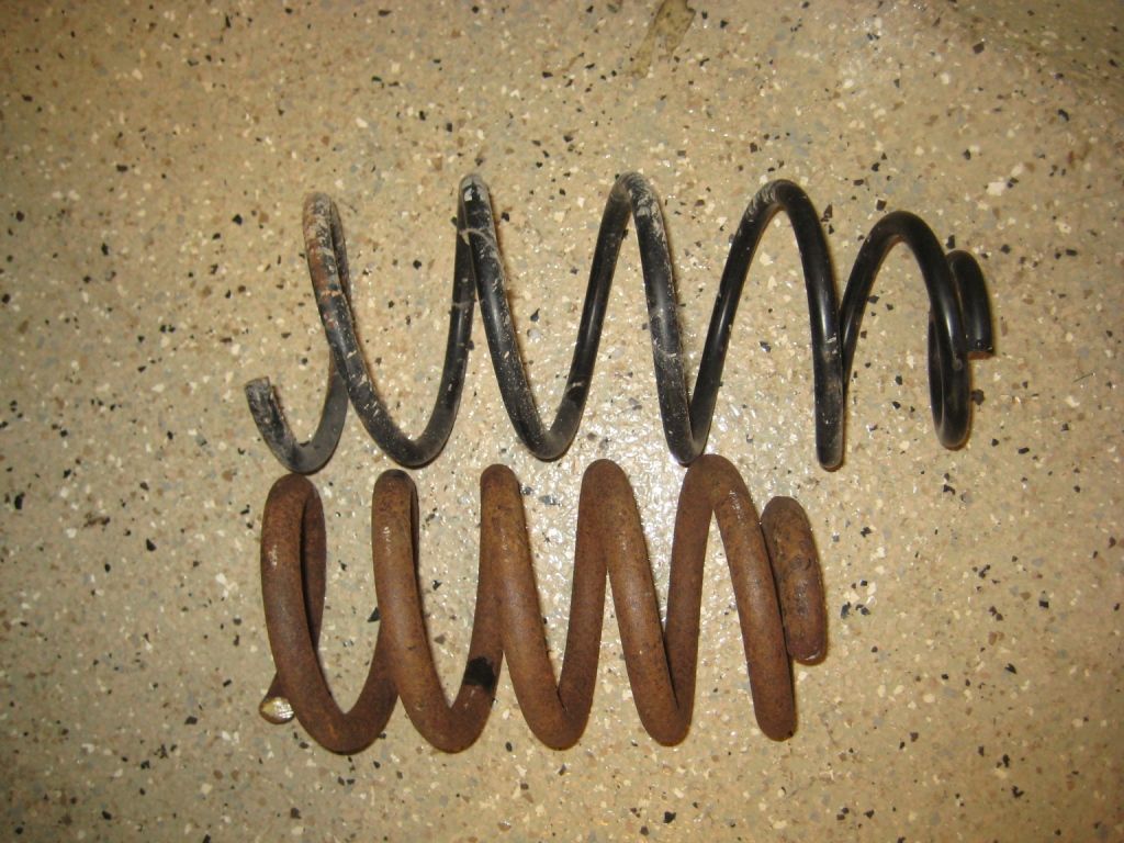

I’m still trying to figure out suspension. I worked with the junkyard Ford van springs a little bit to mock up fitment. I cut off a few coils from the van spring to make it about the right ride height for the Jetta and bolted it together. It fits remarkably well!
Ford van coil spring before and after trimming:
Cut Ford spring next to wimpy OEM Jetta spring:
Ford van cut coil spring test fitted on Bilstein:
Initially I was shooting for around 500 lbs/in in the rear and 400 lbs/in for the front. I have been using a spring rate calculator at this link http://www.racingsuspensionproducts.com ... 20rate.htm
to figure out the approximate spring rate I will end up after the coils are cut. After cutting these van springs to the right height, I figured that the spring rate is now up to 857 lbs/in! This looks like way too much spring, these will blow out the Bilstein sport struts! Let’s look at other options….

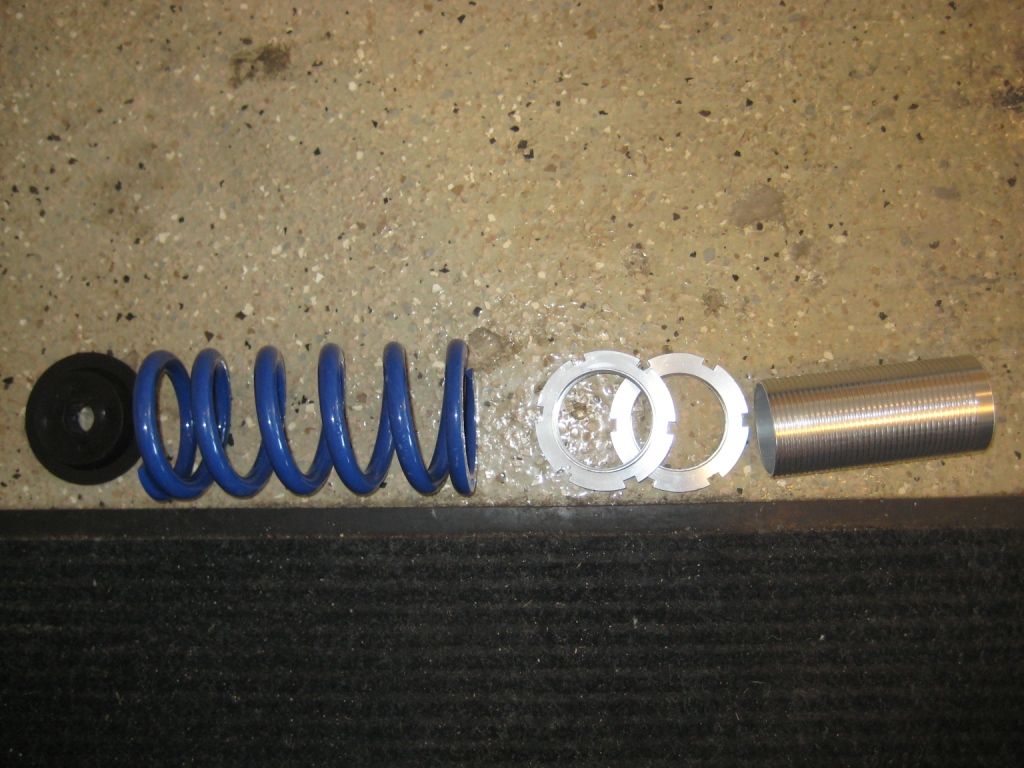

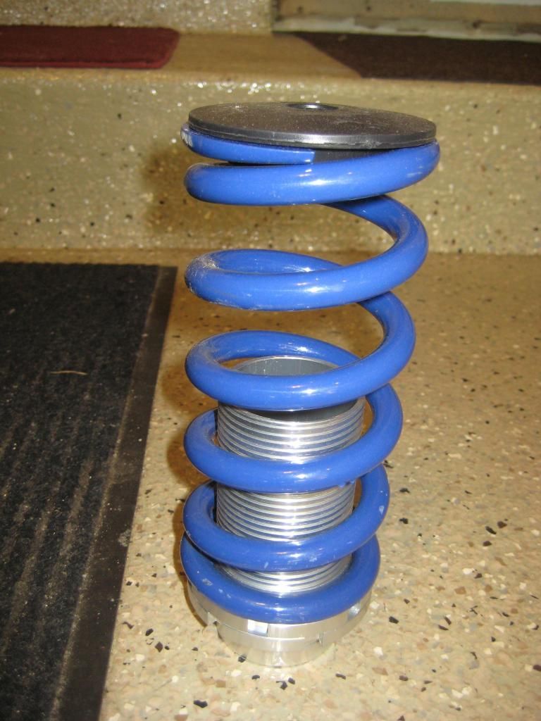

Challenge competitors have used ebay coilovers with success in the past. For those of you who aren’t familiar with these, they are a threaded coilover sleeve with collars for a spring to rest on. The whole sleeve slips over a stock strut and either rests on the stock spring perch, or a weld-on tab. Those E250 springs from the junkyard are cheap at $15 each but take a ton of time to fabricate to work.
I looked on ebay and found a set of coilover sleeves with springs for $45 shipped, which actually works out to be cheaper than the junkyard springs @ $45/4= $11.25 per corner for each spring and coilover sleeve. Since this appeared to be a cheaper, more adjustable option, I went ahead and ordered a set that said they were specific to the Mk3 Jetta/Golf. They came in a few days and appeared to be decent quality. I used the same calculator above to calculate the spring rates and came up with 593 lbs/in, perfect!
I already bought a set of used Bilstein Sport shocks so I test fit the coilover sleeves. The rear test fitted well:
Unfortunately the front’s didn’t work with the Bilstein Sport strut body. The coilover sleeve has a 2” I.D. (internal diameter) while the front Bilstein struts have a 2.17” O.D (outer diameter), meaning the sleeve doesn’t fit over the front strut. Arrgh. In fairness to the coilover sleeves, they DO fit over the OEM strut, but I don’t know why you would want to use the underdamped stock struts with a much higher spring rate that would blow out the shock. Maybe Bilstein’s competitors use a thinner strut body?
Back to the drawing board on suspension. I can make the rears work, but I have ruled out the van springs in the front as too stiff and the “perfect” coilover springs in the front won’t fit without a lot of hassle. Frustrating.

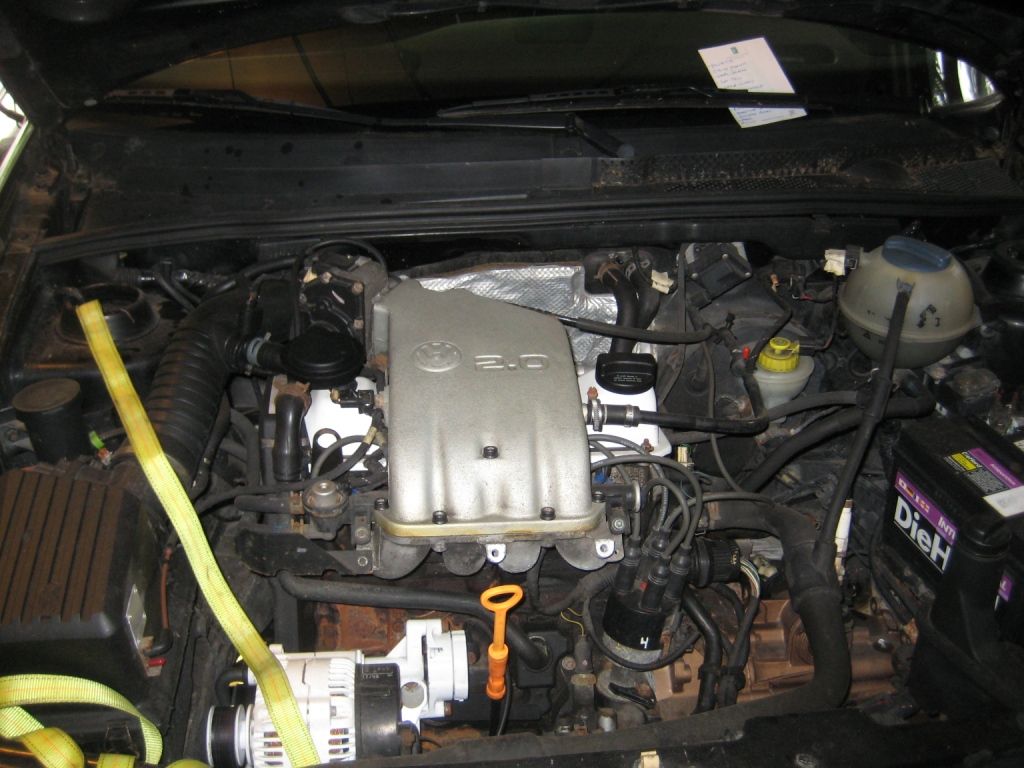

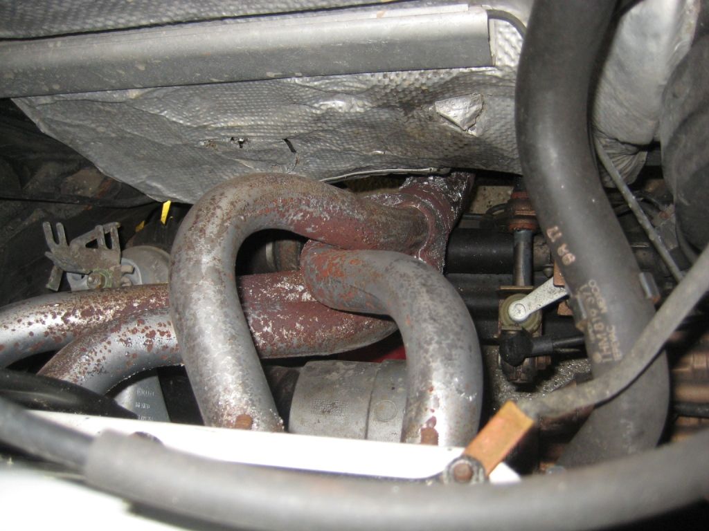

Engine bay a little dirtier, but still the same:
I was looking at pictures of when the headers were freshly cleaned up and cried about how they look now:

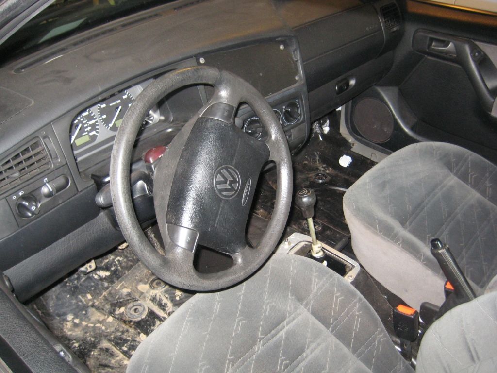

Interior of a Jetta GL devoid of any extras plus some dirty feet:

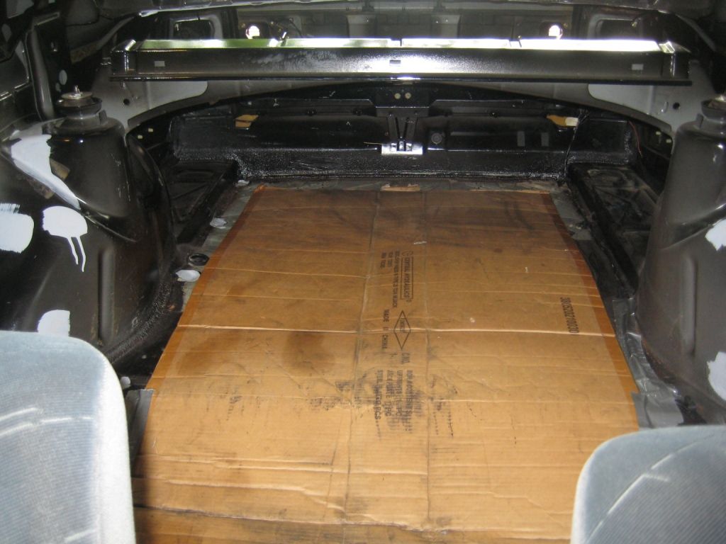

…and a shot of the trunk/rear seat area with cardboard duct taped in place for all the Home Depot runs. (True story – several eight foot Christmas trees , 500 pounds of chain link fence/posts, and lots of 8’-12’ long lumber has all fit in the back of this):

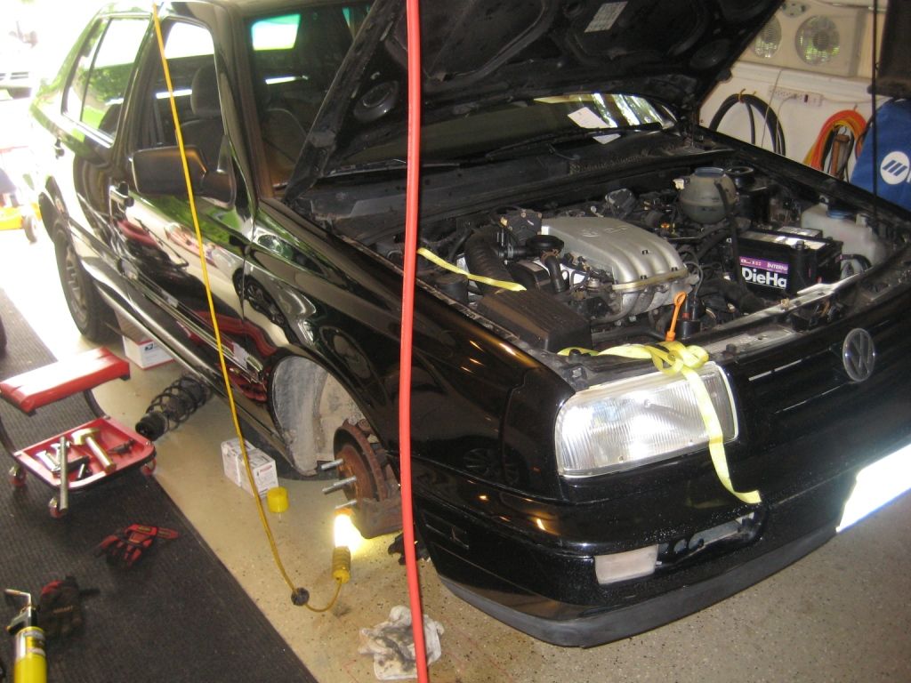

First thing to do on the list is the front suspension, front brakes, and rear engine mount.

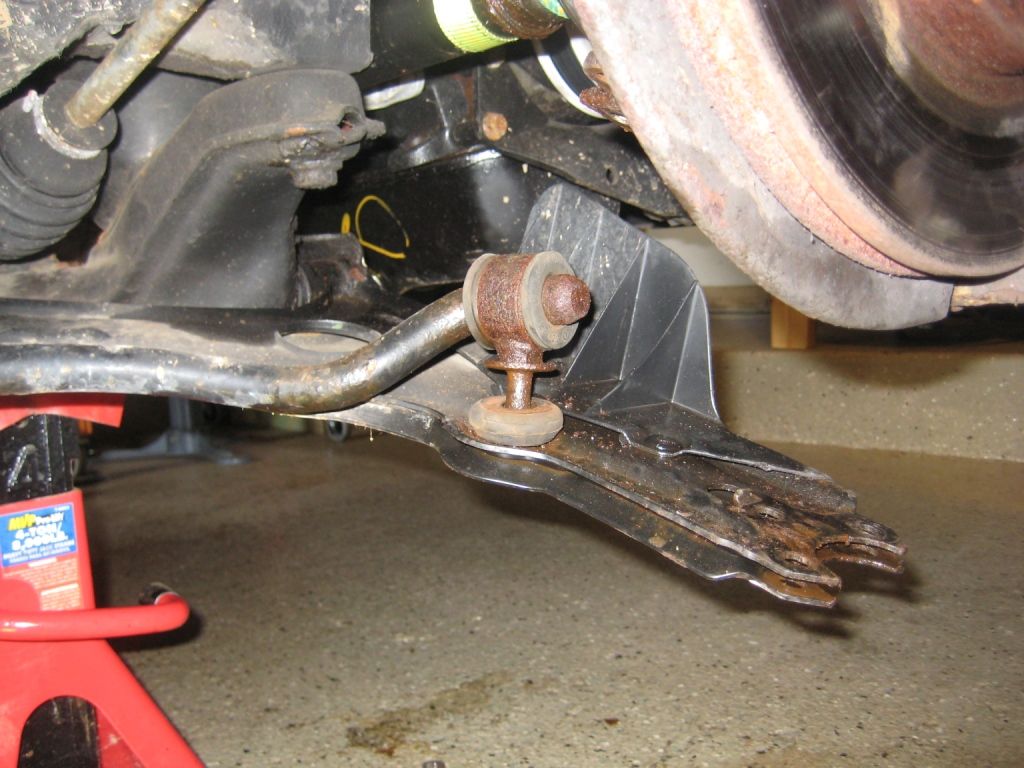

I wanted to change out the bushings in the lower control arms first. I had bought a Prothane Polyurethane kit a couple of years ago to replace all the bushings. Since then I’ve read these may not be the best choice, but what the hell, I’ve got ‘em and they are surely better than the worn out stockers.

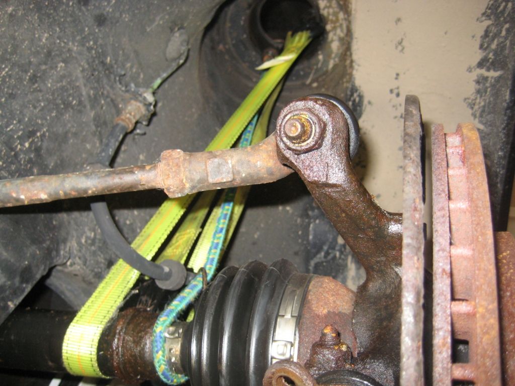

I removed the wheels, pulled the struts, and went to remove the spindles from the control arms. Most of the bolts have been in surprisingly good shape, probably because of the California ownership, but I ran into some trouble with one of the three captive nuts on the fastener that helps sandwich a plate on the ball joint at the bottom of the spindle between the top and bottom of the lower control arm (if this doesn’t make sense look at two pictures below).
You can see the left rear captive nut broke free and was mangled with vice grips to get the nut out. This was after using PB Blaster (penetrating fluid) and heat from a torch. I’ll have to fix this before re-assembly.
The last thing to go was the sway bar connection. You can also see the three holes at the bottom of the lower control arm where that fastener with the mangled nut goes, the spindle slides between the two pieces of metal of the LCA and is sandwiched with the bolts on the bottom and the plate with the captive nuts on the top:
Once everything was disconnected from the LCAs the entire axle with the spindle and brakes was suspended from the shock towers with a ratchet strap and pulled up out of the way. Looking up from the ground you can see the ratchet strap holding everything up and out of the way (the bungee cord was my first attempt, it wasn’t strong enough):
With everything out of the way, the control arms were removed to get to the bushings.

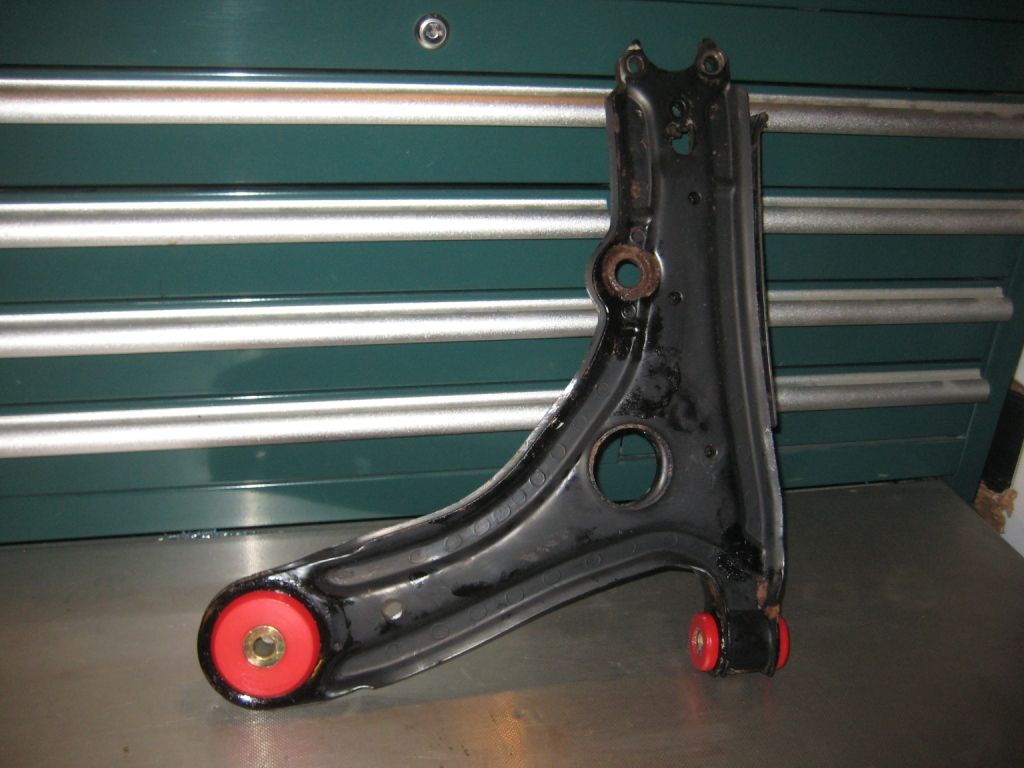

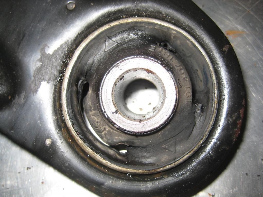

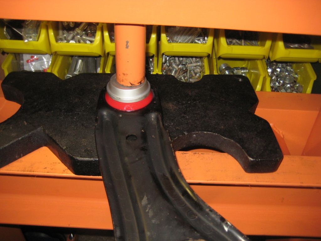

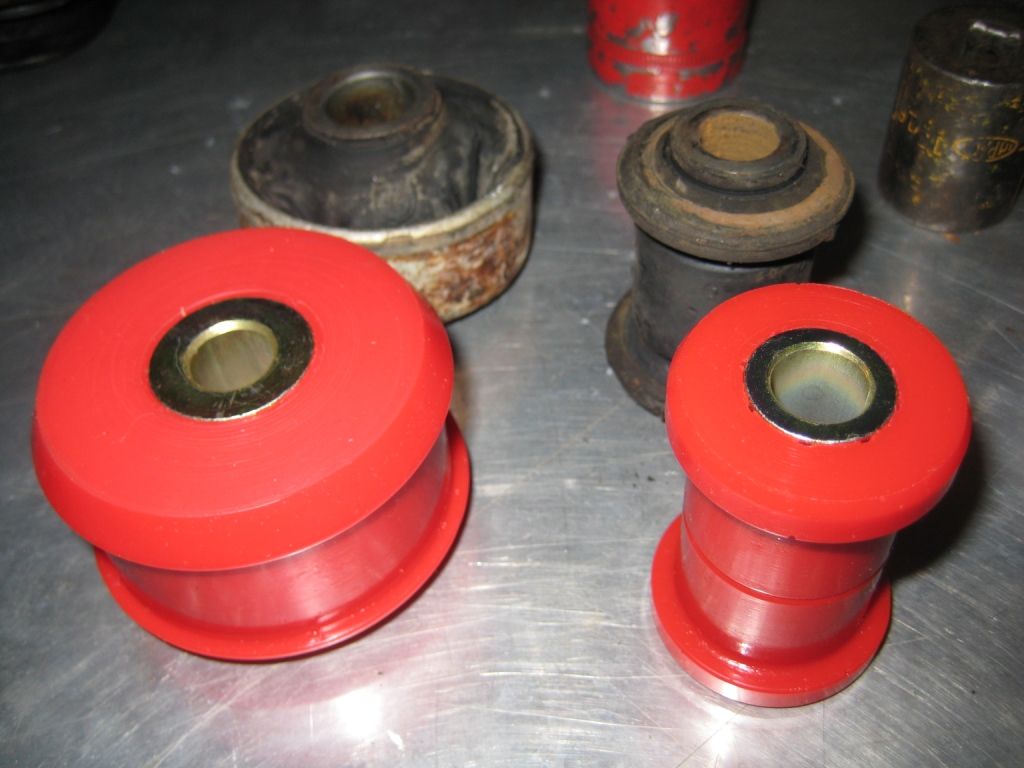

Inspection of the rear LCA bushing shows severe wear, with splits emanating out from the relief holes; look between 3 o’clock and 6 o’clock and a little bit at 10 and 12 o’clock on this pic:

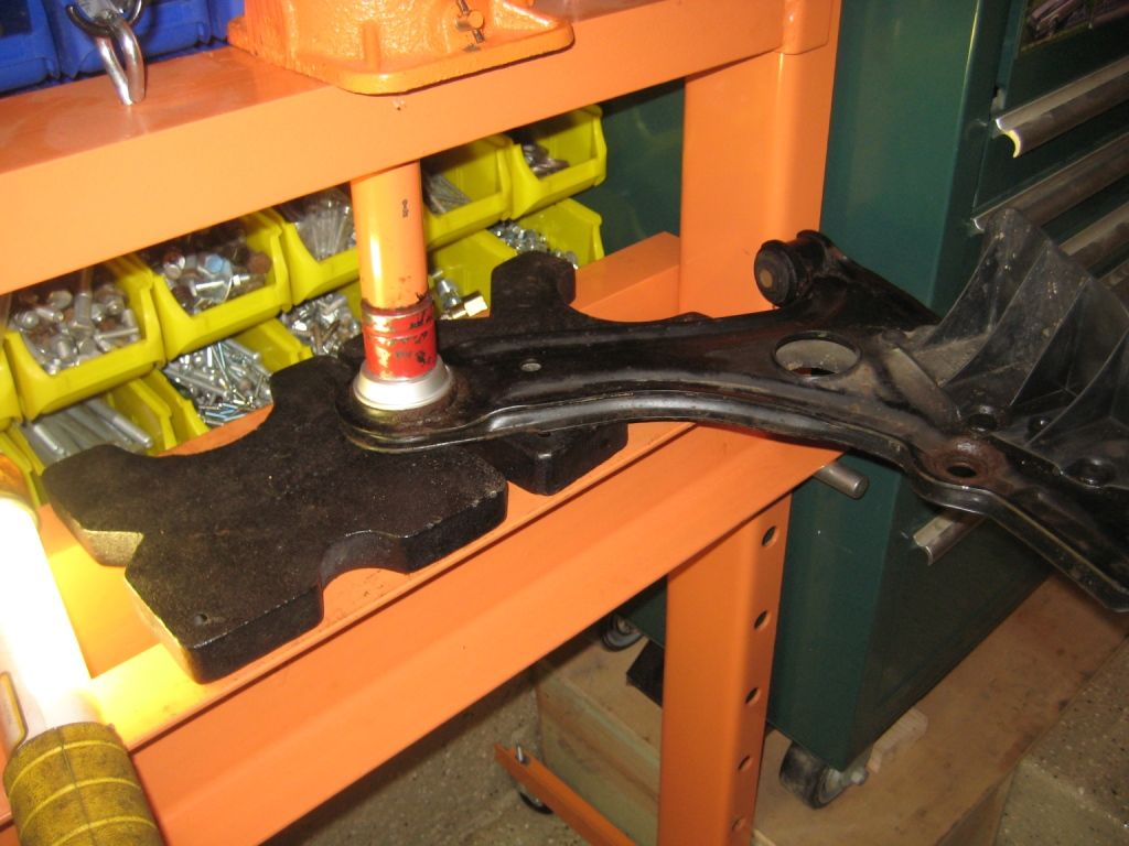

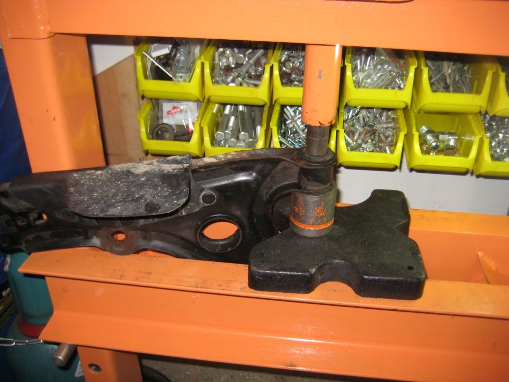

Pushing out the original bushings after 250k+ miles:
Comparing OEM to Prothane LCA bushings:
Pressing in the Prothane bushings:
All cleaned up and ready to go:
Rinse and repeat for the other side.

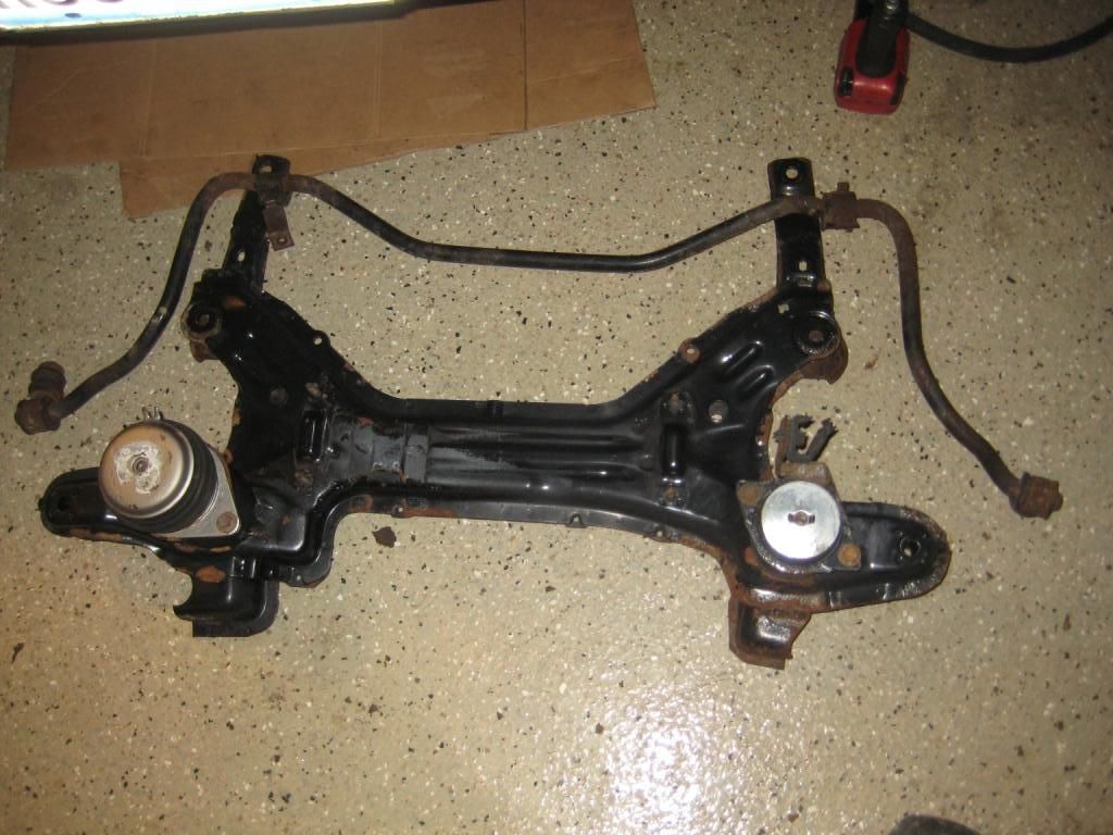

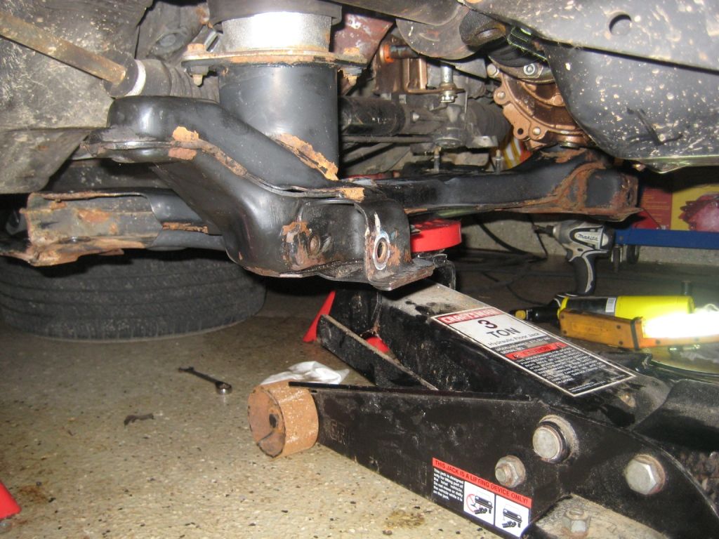

Now that both front LCAs were off the car and the associated parts were disassembled, I decided now was the time to remove the front sway bar. The plan from the beginning was to delete the front sway bar and make up for it with high spring rates. I figure I’ll save some weight this way and hope that the independent front suspension can better do its job when I’m pushing the car to the limits.
I didn’t realize I would have to pull the whole front subframe to remove the front sway bar. After figuring that out, I pulled the subframe and removed the front sway bar:
With the front subframe pulled and the engine mounts within easy reach, it was time to tackle another part of the to-do list.

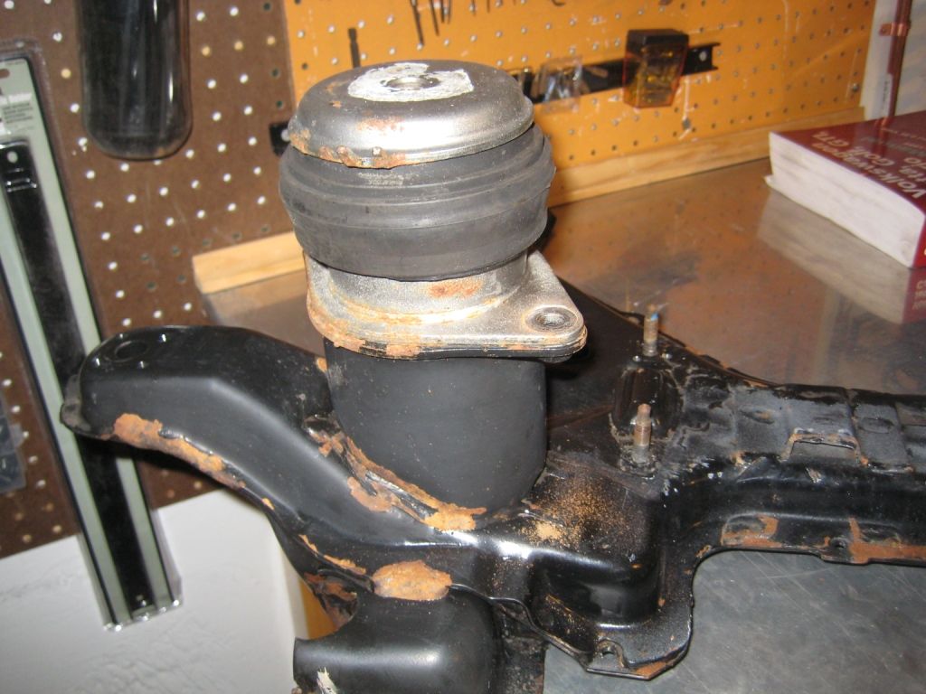

To alleviate some of the vibration, I need to add a little softness back to the motor mounts. The plan is to section a piece of the stock squishy motor mount and make a hybrid motor mount. I’ll take out one of the hockey pucks in my modified rear motor mount and replace it with a section of OEM rubber. The rear motor mount supposedly transmits the most vibration to the inside of the car, I’m going to leave the solid hockey puck front mount and the heavy duty VR6 trans mount alone.
I replaced two of the hockey pucks in the rear motor mount with the squishy rubber, first I held them up to each other and made a mark, adding a little material to the OEM mount knowing it will compress more:
Then sectioned:
Reinstalled:
And of course it is completely invisible when installed:

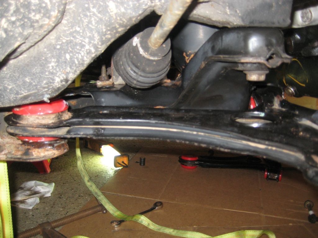

The LCAs were next to be installed. I used all of the sticky grease supplied by Prothane and started banging away trying to get the rear bushing to slide into place first. For those of you trying this for the first time, skip the hammer and grab a pry bar. This pic shows the best position I found to pry the rear bushing into place (it has to slide in from the front towards the rear). This pic also shows some slight deformity where the brass hammer banged the leading edge of the LCA about two inches outboard of where the pry bar is:
Once the rear bushing is in put the bolt loosely in place to hold it and the front bushing pushes in by hand, right side shown here:

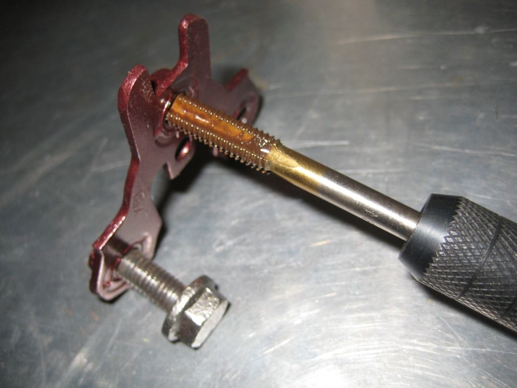

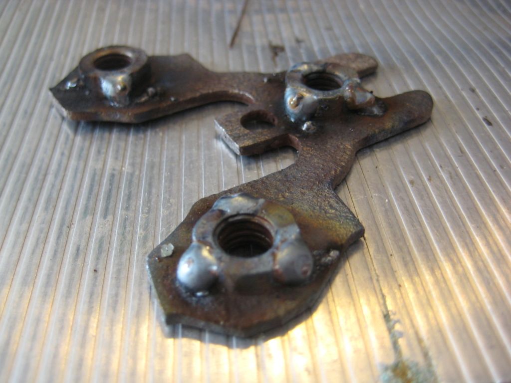

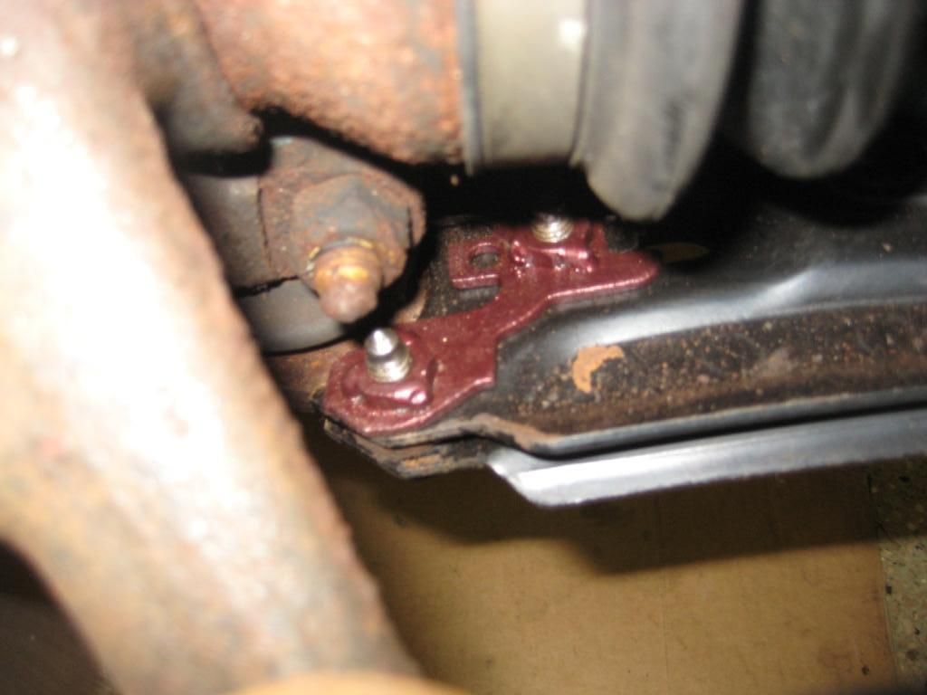

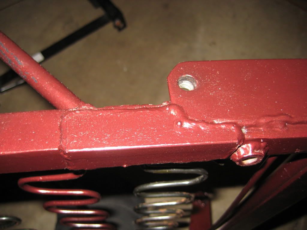

Reassembly of the spindles to the LCAs is next. The first thing I had to do was to fix the captive nut that got mangled mentioned above. I spot welded all the captive nuts in place first:
Then added a coat of paint (left over metallic maroon from a CJ-5 project almost 20 years ago) and cleaned up the threads of the nuts and bolts with tap and die so I don’t have any issues next time I take this apart:
One of the bolts was pretty corroded, probably the one that ripped the captive nut out. I’m still using it:
Back together, already dirty, but the best looking bracket no one will ever see:
