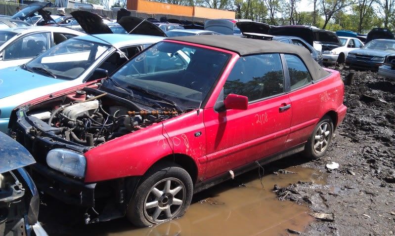

Looks good so far. I own an mk3 jetta...recently went to my local junkyard and saw a red cabrio and was picking at it a bit haha i'll include a picture. Don't know if you have been to victory auto wreckers but there are always mk3s...there were 3 jettas besides the cabrio all 2.0s. Picked up some glx tail lights the other day and all of my missing bumper inserts. Don't know if you need any parts as your exterior looks all intact but i thought id share!

That's funny...when I had a mk3..and everytime I went there they didn't have shit....now that I have a mk2....I went out there and AGAIN they didn't have shit...its just my luck!
Ah that sucks, they take a picture of every car they receive and post it on their website so browsing that once a week doesn't hurt! They also have a car list on there but I found more jettas then what they said they had. I mentioned that to them but I don't think they care haha.
