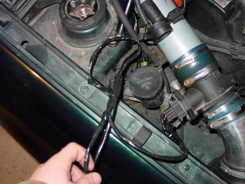

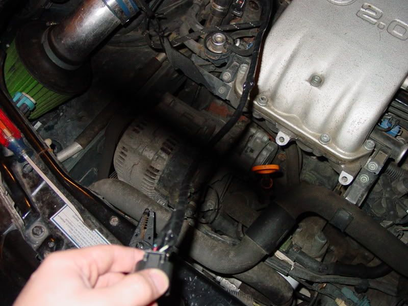

Starting it off, Tonight i lengthened all of the wires for the sensors so that they would reach across the bay

1. Unplug any and all sensors on the intake system (for me it was the IAT, PCV Filter, MAF, TPS)
2. If not already done (like i had done) lengthen all sensors wires so that they will reach to apporpriate places, i personally just lengthend them all to reach the fender.

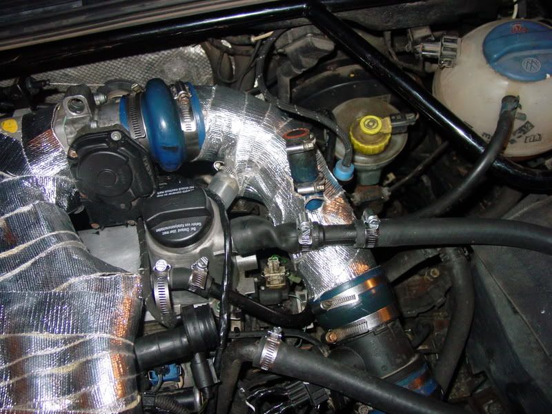

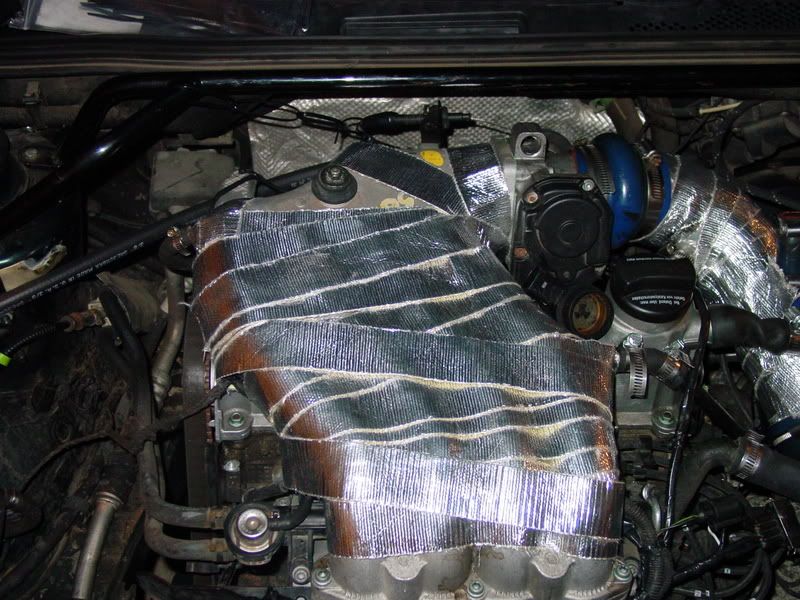

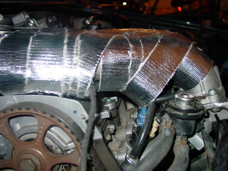

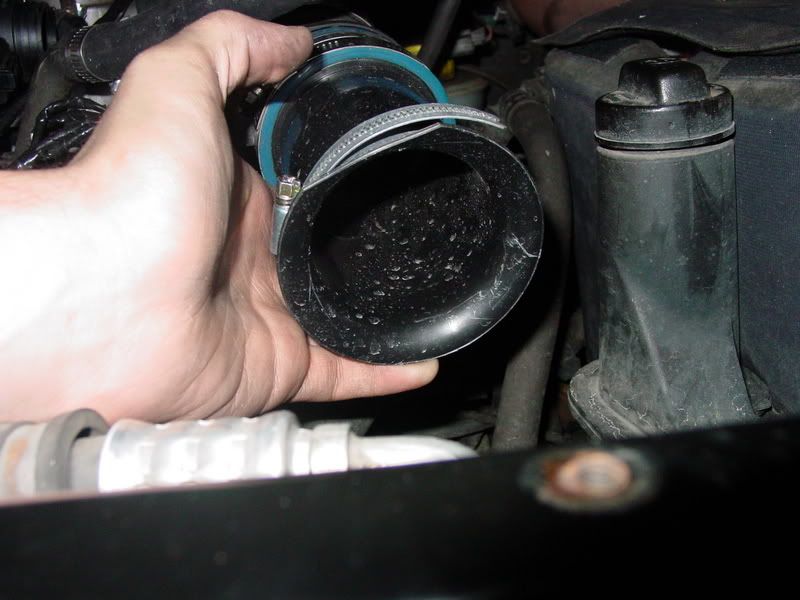

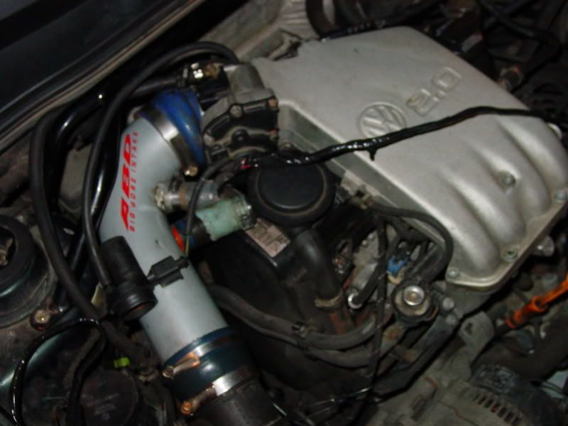

Ok, heres some updated pictures, i still have to get the installation pictures but these are after i applied the heat wrap and hid the wiring, i am aslso running a little "velocity stack" that i made out of spare plastic, i still need a filter for it though.
the manifold:
I hid alot of the extended wiring under the manifold inside of the wrap:
this is a bad image, but allows you to see where i placed the IAT sensor on the back of the manifold:
my ABD big bore wrapped up:
I managed to adjust the throttle cable enough so that it is not bent, or stressed, its worked this far and i havent had any problems:
and the "velocity stack":
